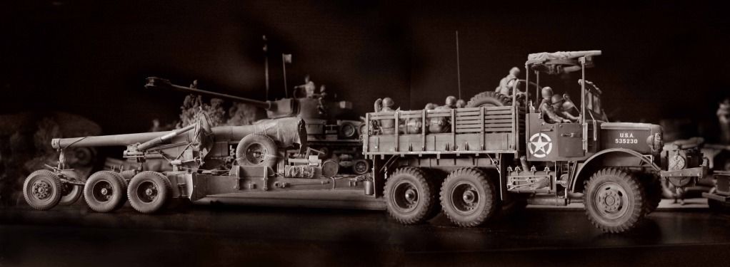

There IS one other option for pulling the 155mm and 8in guns = Mack NO6!
(Sorry but just could not resist.)

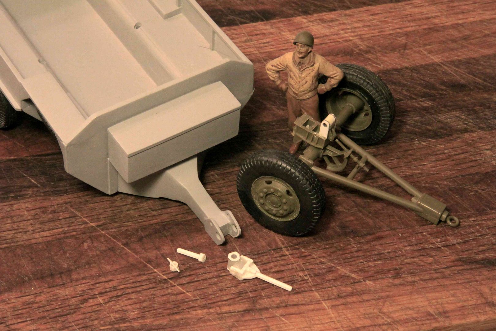

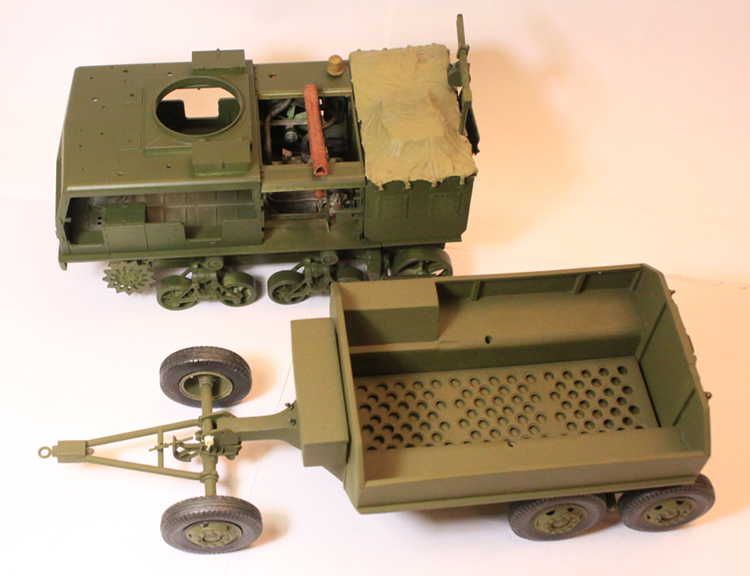

I'm working however, on another option use for the HST - towing the M23 8ton ammo trailer:
LIFE Magazine photo

Actually most of what you need for the adaptor comes with the AFV guns - In the TM it is sometimes called a bustle, griddle or clamp.
The MACK hinge or custom pintle is basically a big universal joint. I mounted a piece of Evergreen tubing in the Mack to act as a receiver and now both the special hinge and the standard towing pintle have a piece of tight fitting hexagonal rod to act as a shank for inserting into the receiver tube.

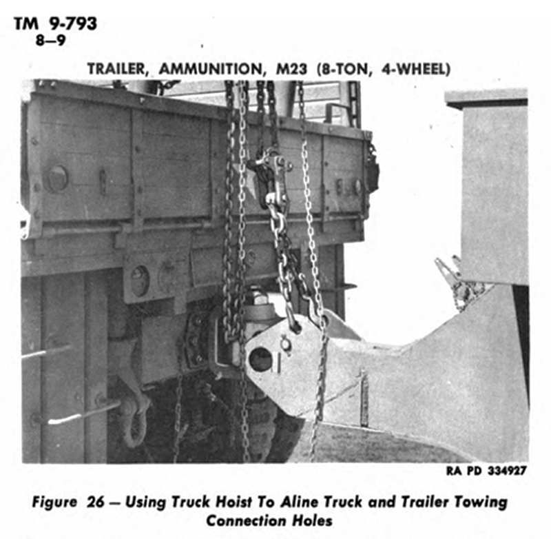

The towing tongue on the M23 ammo trailer is formatted similarly to resemble the attachment fitting on the bustle.
M23 - 8 ton ammo trailer sometimes used in conjunction with the same M5 Limber used to tow the big guns.

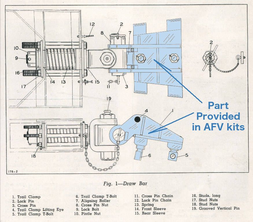

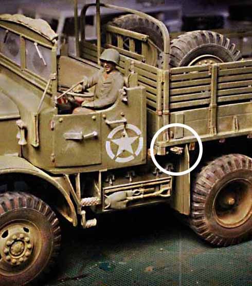

One more shot regarding the special MACK hitch device - and the towing clamp that is included with the AFV Club 155mm and 8in guns: (This part is also required for use with the M5 towing limber so AFV had to include it.)

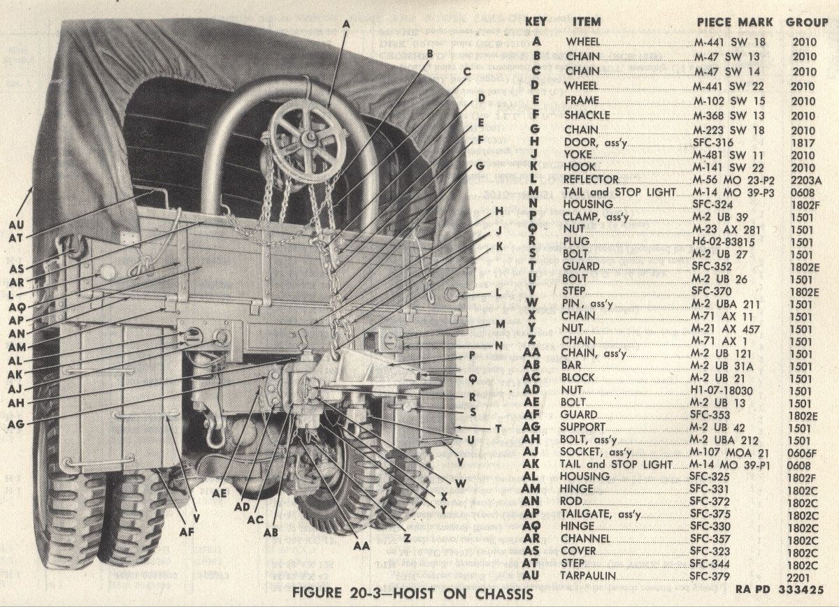

For doing lessor towing jobs the Mack also carried a standard military towing pintle in a false receiver placed under the loadbox right behind the cab that could be exchanged for the massive towing fixture.

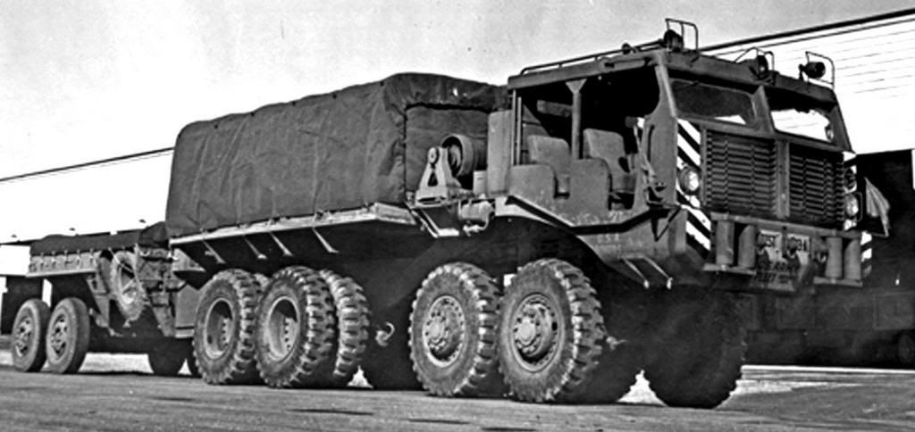

The never produced 8x8 successor to the Dragon Wagon the T26 Sterling was also slated to use the massive Mack hinge/hitch:
