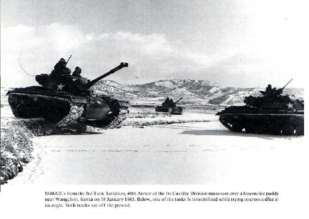

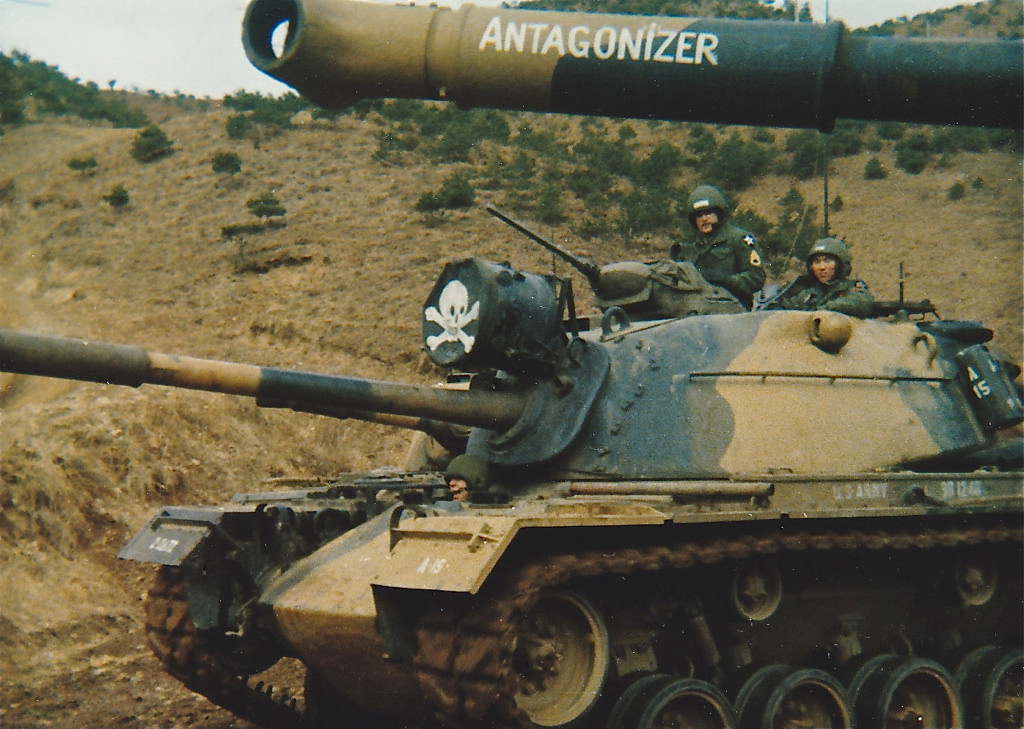

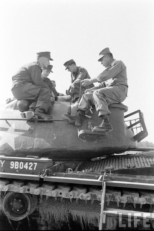

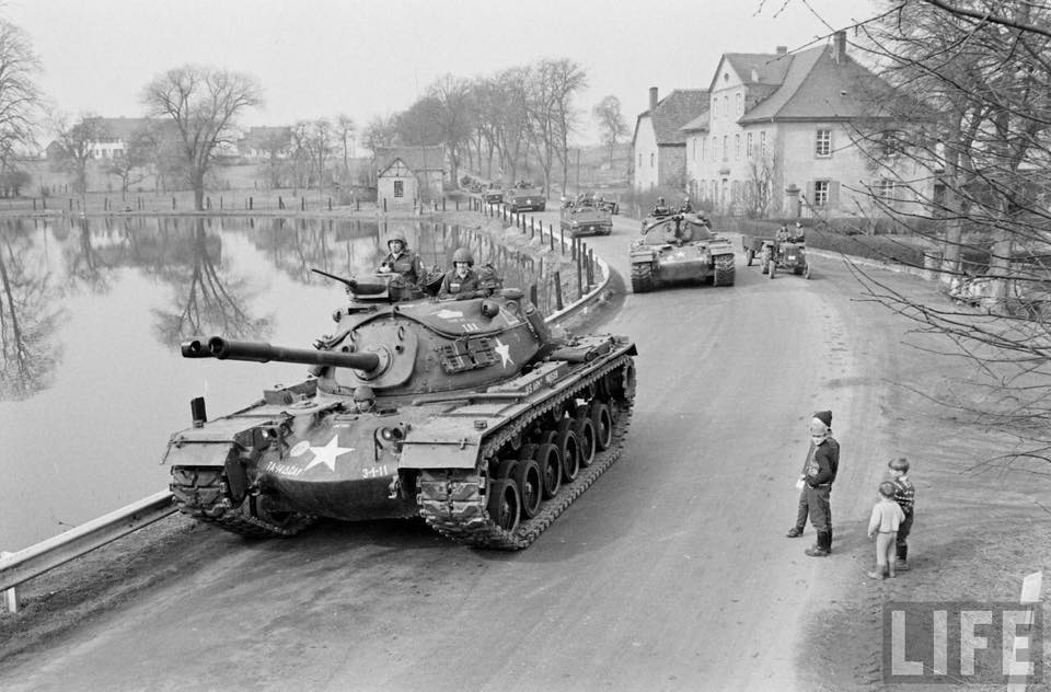

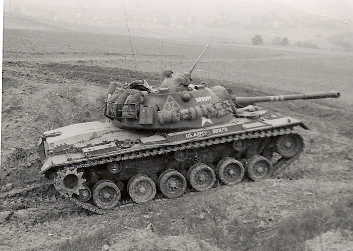

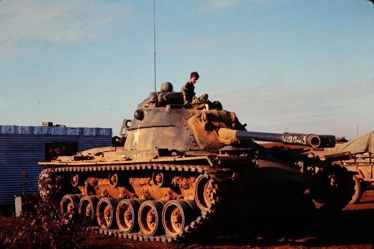

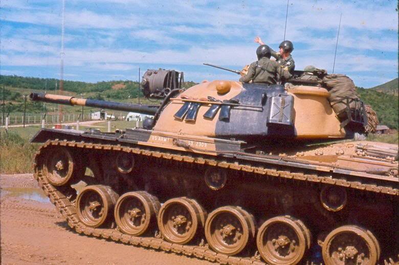

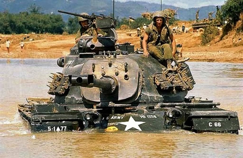

Posted: Wednesday, February 19, 2020 - 07:18 AM UTC
US Army also used the M48A2C in Korea
Photos of vehicles in Korea and West Germany
Some vehicles were also useed in Vietnam
entire network: 17,325 Posts
KitMaker Network: 1,940 Posts
Posted: Wednesday, February 19, 2020 - 07:21 AM UTC
The M48A2C was used across all units and locations the US Army operated in the '50-'60s.
