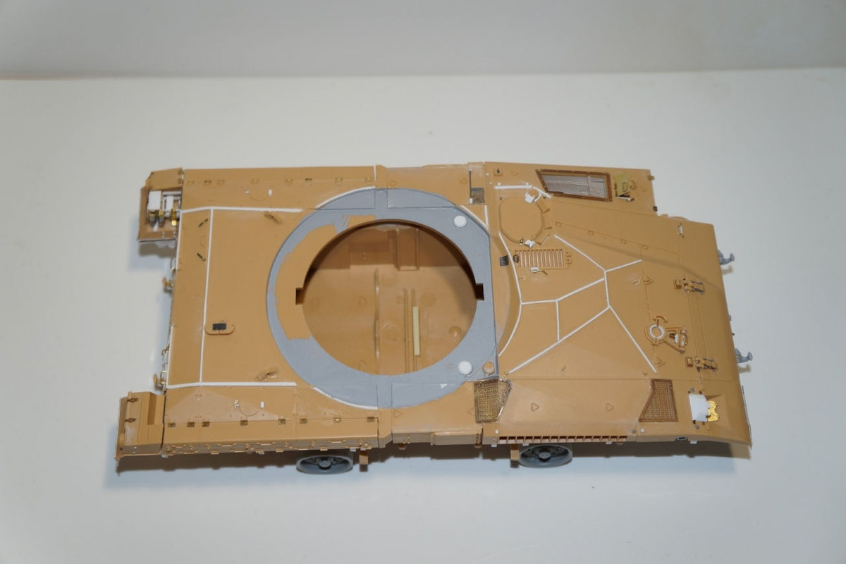

Posted: Monday, February 17, 2020 - 08:15 PM UTC
Guys, Takom is right.
Tamiya/Academy Mk1 2 is 21cm and the Takom 21.7cm
I uploaded photos of model and Tamiya and Academy are 7mm shorter the should be.
Regarding MENG Mk3, I have them on stash and they looks like they are bigger than Academy Mk3
At the moment I can not compare them.
If someone have info on them would be much appreciated.
Hobby Boss Mk3 is same lenght as Academy so that means that they also got the lenght wrong.
MENG and Academy Mk4 are the same in lenght, but they are completely different tanks than Mk1 and 2 and at this moment I have not info are they the right lenght.
I am not rivet counter but 7mm is way off even for me!
