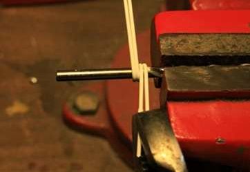

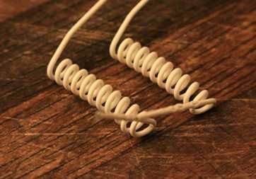

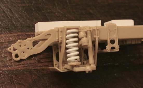

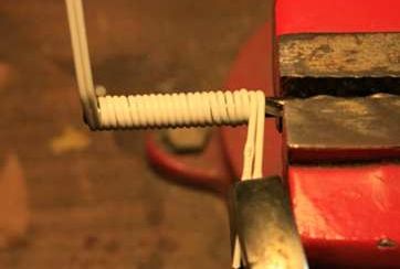

I have a method for making coil suspension springs using Plastruct's plastic coated wire. However I don't know if they make this product in small enough diameters to satisfy your needs. (3/64" dia. is the smallest they make.) However this technique should work for even the smallest diameter uncoated wire.
I started out using the traditional method of wrapping a single wire around the proper sized drill bit held in a vice. The problem there was after rolling the spring I tried to expand it but the coils came out with an irregular spacing between the loops.
I then struck on the idea of rolling two wires at the same time. This keeps the spacing between the loops uniform and allows you to make two matching springs at a time with each effort.
An immediate visual improvement in the suspension for the many
Oshkosh built US Military vehicles and heavy truck models being offered.
