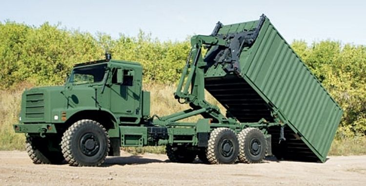

Shown here is a PLS 10x10 vehicle using the Container Handling Unit (CHU), you might call it "the Claw". It grabs and can handle a standard ISO 20' foot freight container: (Below that, the experimental Oshkosh 6x6 and 8x8 Load Handling Systems.)

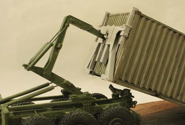

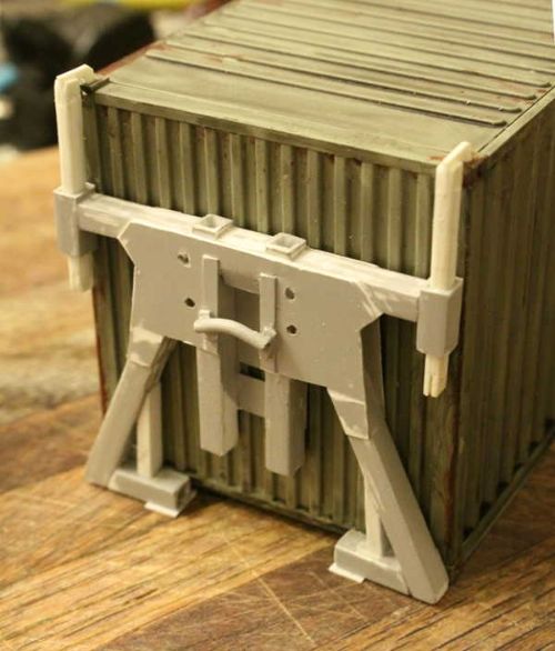

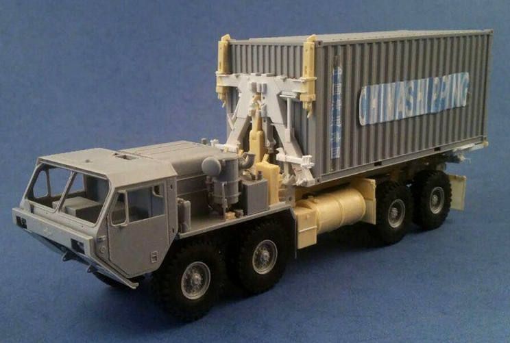

EUREKA! The CHU works as designed (by the manufacture!)
Shown here is my CHU still under construction being used on my kit bashed Oshkosh 8x8, 16.5 ton LHS prototype.
p.s. On this model of the CHU the bottom attachments are fixed pins and the top are movable hooks held in place by friction. This scale CHU is easily removed (it is not glued on) and when completed will also (hopefully) work with the shorter half and three-quarter tall containers.

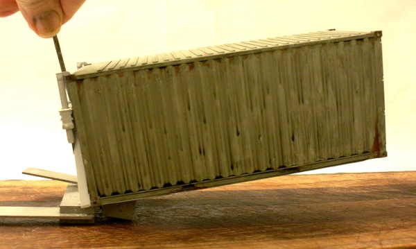

I had to test it. I had to know.
So I blocked up the bottom of the CHU and slid a needle file down thru one of the hollow square tube legs of the CHU. I wanted to see if it would hold up the container like the real thing does. SUCCESS!

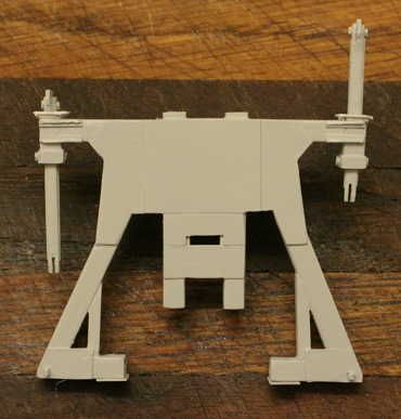

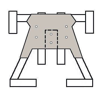

First two images show the cutting plan for the 3/16" square tubing and for the front & rear gusset plates - then weld the CHU frame together. (I mean glue together.) - - - - - Line drawings not to scale.
_____________________________________________________________________________________________
I needed large gauge square tubing - had none - so started by taking some Evergreen 3/16" "ELL" I had on hand and gluing up the needed square tubes.

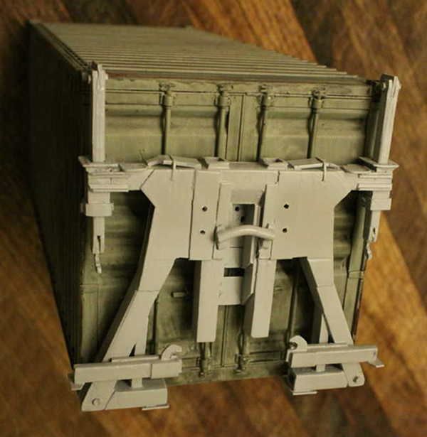

Left and Right on-truck, ISO container lock downs now added to my CHU:
These two structures down low on the legs of the CHU are actually holding fixtures for several accessories used with the CHU. The hook shaped object is actually for holding a half-height container.
The outboard end of these fixtures holds the container lock down to be used with the transporting vehicle.

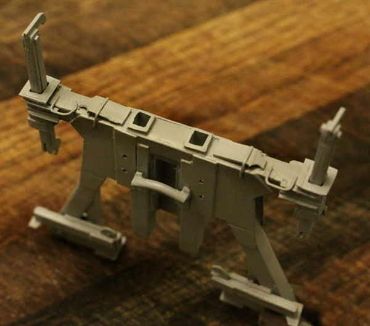

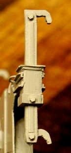

Construction of the upper container hook arms and finished upper details of the model CHU:
Unfortunately there were not very many technical drawings of the CHU available.

F.Y.I. - I intentionally spaced the lower container connection pins just slightly on the narrow side. When I attach the CHU to the container this means I have to force the lower legs open just slightly. Doing this, the lower pins pinch the container attachment fixtures. This improves the physical connection between the CHU and the container.

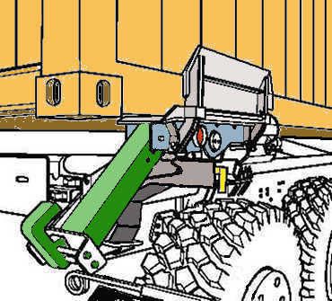

This is my thinking on how the lower hooks are used with the half-height containers but I cannot find any photos to document this.
Lower hook in stowed position . . . Lower hook ready to use . . . . . Lower hooks engaging top fittings on container.

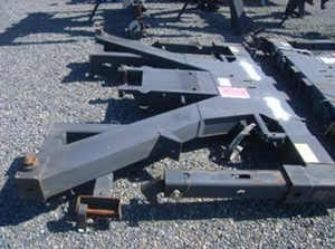

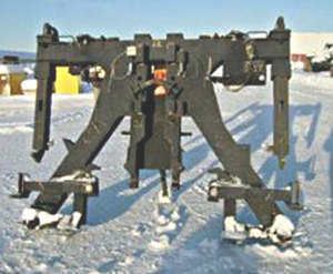

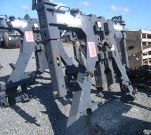

Miscellaneous reference photos on the CHU - sorry the quality is so poor - they are all I could find!
Jake leg that allows CHU to be stored on the ground but
in an upright standing position.

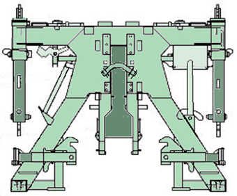

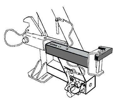

Plan drawing for construction of the two CHU hook assemblies: (Remember to also leave the gap indicated by the red arrow.)
Hooks (Blue) - Top hook is fixed (glued) - Bottom hook is pinned (hinged) and rotates 90 degrees.
Friction spacer side bars (Green) are narrower and thinner than main bars. (Orange)
Center bar (Gray) has the same cross section as the main bars but is shorter to allow for hooks.
Hex nuts were added later and serve only as decoration.
Bottom two drawings are from the TM. Including this gap in the vertical hook arms will give you, first of all, an additional detail on the movable hooks. However if in the end you find you want to deal with multiple containers of different heights, adding this item now will allow you to keep your options open for the future.

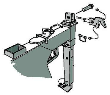

Recent progress on this project:

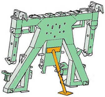

Those two vertical poles stored one under each "arm pit" are the two pieces that form the standing support jake leg. This is used when storing the CHU in the upright position.

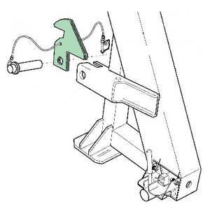

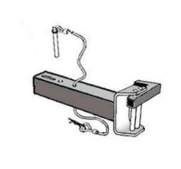

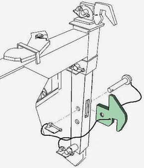

Some info into how the lower "Rotalock" locking pins work:
Lift that spring loaded retainer plate (Blue) and shift the handle (Green) to the vertical position. You now have the Rotalock in the locked position. Finally turn that star shaped knob (Gray) to tighten the lock and take any slack out of the connection.
