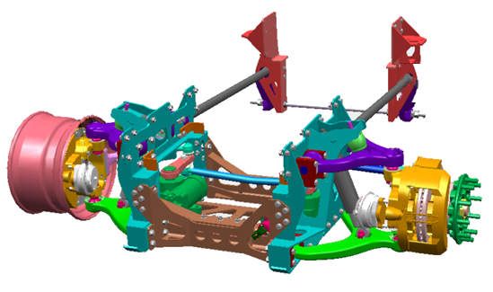

The images above are very interesting - will be fun to see how you decide to resolve the rear steering - it looks like the truck would essentially include three front suspension/steering modules - with one up front and two in the rear (but flipped back and forth). I can't remember if you purchased two kits or not...I've scratch built TAK 4 suspension modules for a MAXX Pro conversion - not exactly the same, but I'm sure a guy with your skills can tackle it if needed!
The steering mechanism for the rear will be interesting to see too - wow - lots of good stuff. Looks like there's a bracket (in blue in the diagram) between the frame rails supporting the mechanism...sorry to be stating the obvious - just a very interesting challenge.

Edit: the suspension modules I built, and noted above are the Axletech International 5,000, which while similar to the TAK 4 are not the same - each unit has two coil springs. You can see them on page 4 of a build I did a few years ago called 1/35 truck fabrication shop, on the dio forum. In any case, I'm looking forward to your solution!

Setting that aside for a moment . . . . I continue to be more than a bit impressed/amazed/questioning of the TAK-4 suspension design being based on every axle having a potentially steerable spindle/king post/hub. (Whatever you want to call that.) To create a fixed, non-steering axle they just add a fixed, non-moving connecting rod to the assembly. To reverse that idea this design allows them to add a steering mechanism when necessary and create a movable axle. (I don't mean in the field but in the design office.)
Given that, I don't see the great problem with converting/creating the needed steering axles on the plastic model. The Mk23 rear axle design allows for the addition of steering gearboxes, pitman arms and drag links to turn them into steerable axles.

Yes - the module suspension is something pretty cool. From your diagram, it appears that the rear (axle) is the same as the front - just inverted - coil springs facing rearward on the back unit. Next, I suppose (axle) 3 will, as you indicated, be a conversion of the typical module from non-steer to steer. I've got to hand it to the design team for creativity - as you point out, not only does it appear that each module can be made to steer, but it also appears that they can face two different direction - differential input shaft and all!
As for the steering, I'm guessing you are indeed right, with two kits you ought to have plenty of parts - but might need to fab up a carrier - which ought to be interesting in that it will need to direct two opposing axles - I say cool! and look forward to your next update -

Yes it looks like they can face either way, be powered or unpowered, steering or non- steering OR EVEN . . . .
Coil spring or torsion bar!

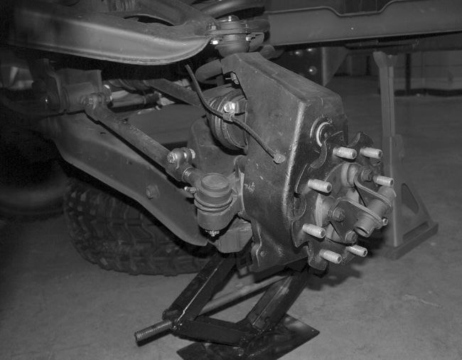

All independent suspension/axle assemblies can be made to turn. When they are setup as a "rear end" non-turnable assembly, they are then limited by a radius rod.
Here is an example from a HMMWV. You can see that the hubs are the same as the ones used on the front, except they use the radius rod to keep it in place and therefore it can't turn. That radius rod is also how they set the alignment "toe in/out" on the rear.
Not to imply that you don't already know this though.

Well I did know that, including the point about adjusting the rear alignment, however, for instance on a Formula One race car, the non-steering rear spindles connect to the A-arms with a four point connection. (Like the rear axles on a MA3-537.) Therefore the rear spindles cannot be made to steer but I would think this four point connection would be stronger and more durable so I have spent some time wondering why Oshkosh/Pierce went with a two point connect on all axles?
Perhaps interchangeability of parts and reducing inventory is/was a more important consideration to the military?

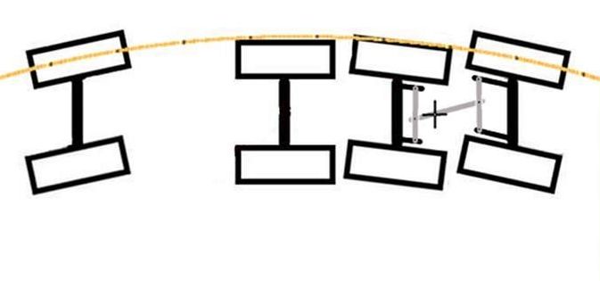

Yes, I will have to fabricate a carrier for the rear steering gearboxes but that should be little or no problem once the suspension units are mounted to the frame.
If you study the steering arms on the #3 and #4 axles in the Oshkosh/Pierce drawing you may notice that they are of different lengths. The rear most axle's steering arms are longer. This allows the rear most axle to turn to a greater degree (angle) than the #3 axle.
I suspect both the axle #3 steering arms and the pitman arms attached to the steering gearboxes are a shorter length as well.

As to the steering gear this is what I am now thinking:
At the center of the black cross is where I think the steering gearbox or boxes would be located.

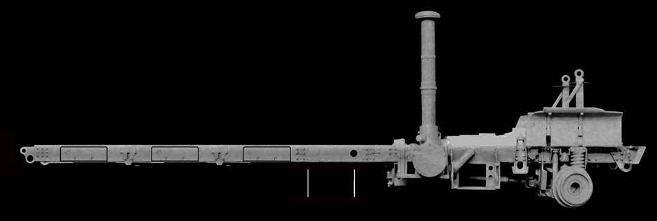

This is more of my photoshop work and NOT actual construction but I think I'm getting close to cutting actual plastic.
I added the fourth axle of course, then added a frame extension right behind the cab. (The two white tick marks below the frame show the length of this extension.) Finally, I shortened the length of the tail frame just behind the last axle.

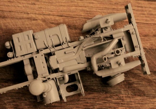

Took a tip from Gino (just one?) and added the intake and exhaust pipes under the hood. Then took it one better to add some piping and electric lines under the cab.
