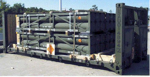

The M-1 Flatrack:
This is considered by the military to be the ideal flatrack. However the increased weight of this bulkhead flatrack AND the increased cost of the design has forced it to be designated as "limited standard".

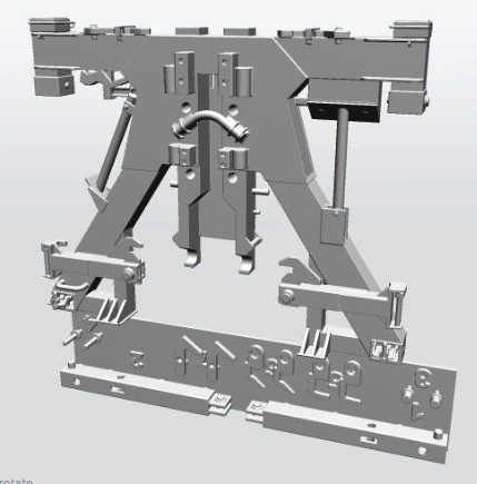

Digital renderings come from the Shapeways website:

Mike Goldberg's digitally printed CHU has now been uploaded to the Shapeways site and is available here for purchase:

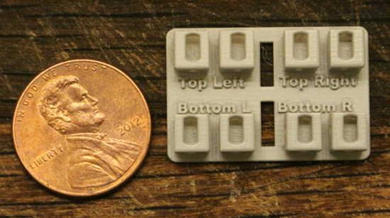

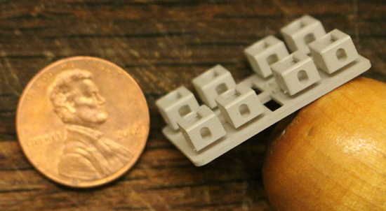

Here are Mike's new ISO Corner Blocks that arrived today from Shapeways.
(I have added a light coat of primer in order to see them better:

SOON TO BE NEW PRODUCT ANNOUNCEMENT:
Just in the odd chance that a few out there have missed this. Mike Goldberg has been working on digitally reproducing both the corner blocks for scratch building your own containers
. . . . . . . . . . . . . . AND . . . . . . (drum roll please!)
an actual scale CHU digital model for we nuts out there interested in the supply side of modern combat.
TA-DAH! - Get ready to place your Shapeways orders!
(All images above are the property of Mike Goldberg - MS Productions)
Link to Mike G's page on the design and creation of his CHU:

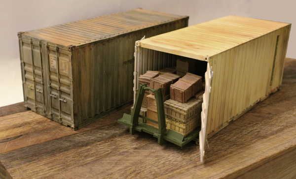

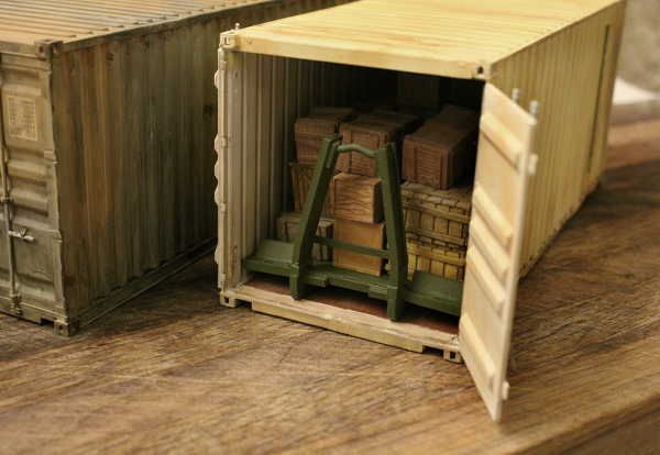

Worked some on the CROPS Flatrack tonight but the roller end is as yet, still un-detailed. Also finished up the open doors on the Trumpeter container.
This is almost every resin shipping crate I own and the CROPS rack is still not half full.

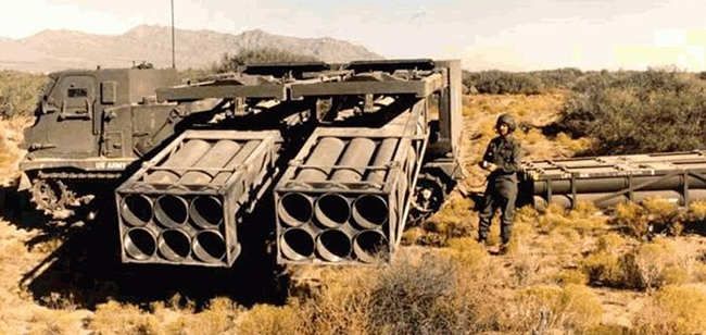

They certainly seem fairly basic and buildable out of brass tube and Evergreen shapes.
Another option would be using Voyager PE set 35007 :
and scratchbuilding the tubes...
entire network: 6,747 Posts
KitMaker Network: 87 Posts
Posted: Wednesday, November 15, 2017 - 06:07 AM GMT+7
Once again I wish these and the Patriot rocket reload pods were available separately to use as Flatrack and HEMTT loads.
Anyone have the specs or a technical drawing on these? They certainly seem fairly basic and buildable out of brass tube and Evergreen shapes.

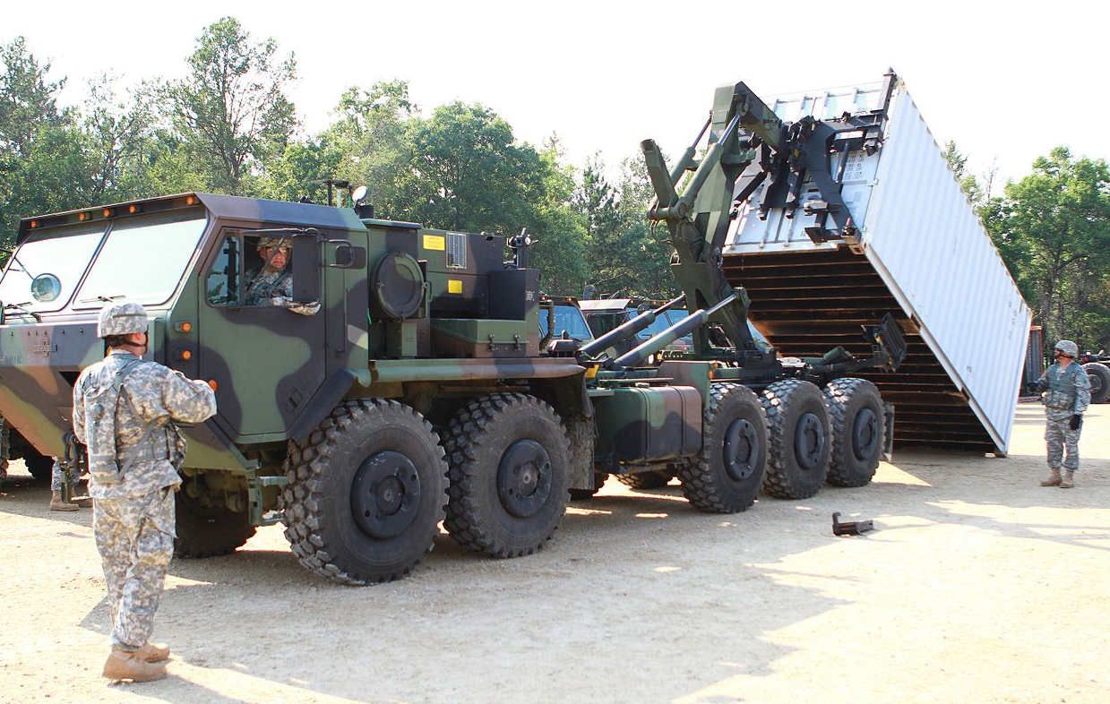

Beauty shot here:
PLS with 20' civilian container using the original design CHU to grab the load.
Note: Container load lock laying on the ground waiting to be applied.

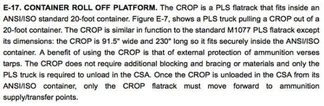

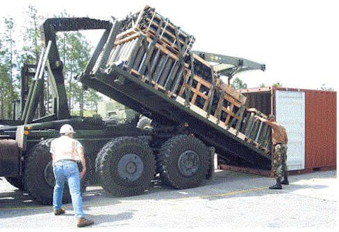

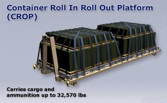

I apologize that this thread seems to be getting so fractured. If you have not been following along it has probably gotten to the point where you might not know just what is being talked about. First it started with the Mk 8x8 LHS(The original Topic), then onto the CHU (Container Handling Unit), then container lore in general and now I throw in a side trip looking into the CROPS Flatrack.
This thread, like my modeling, just seems to go wherever the interest leads next at any given moment!
Again I apologize and promise to get back to the Mk eventually. I hope on one level or another everyone is enjoying the journey. I know I am.
