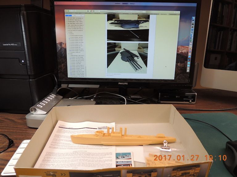

I'm going to build a Gulfstream 1/350th kit of the USS Ward I have had for many years.

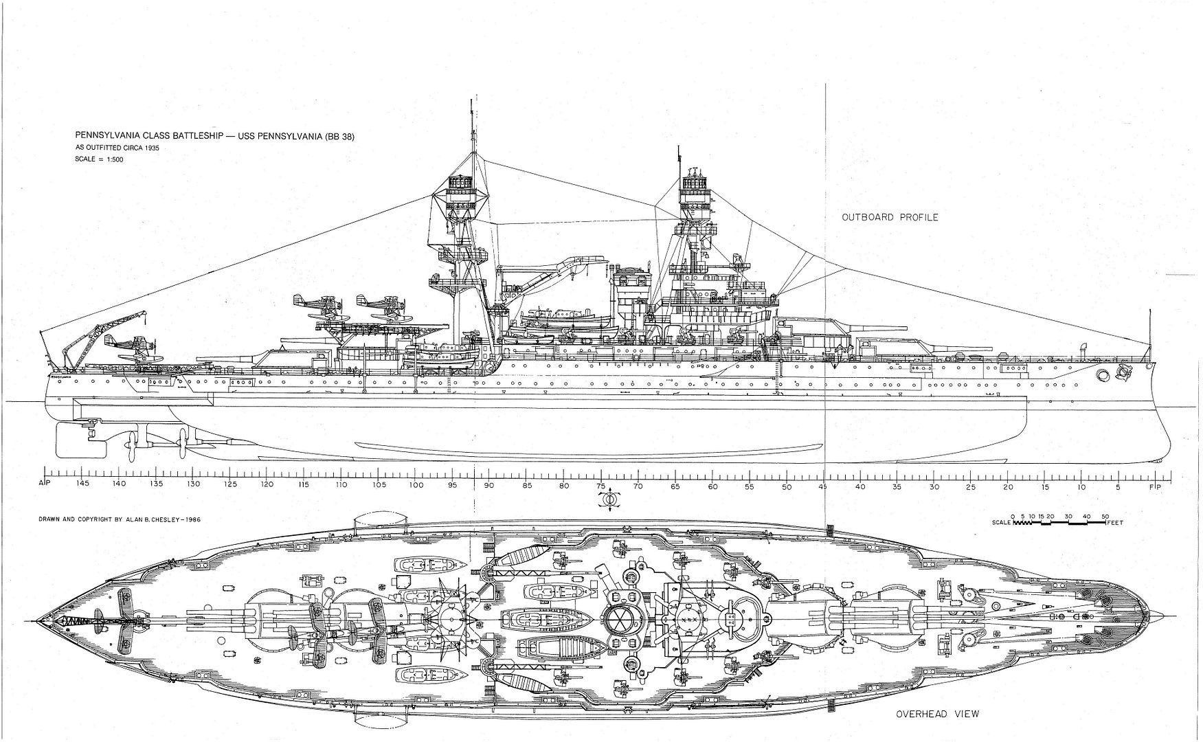

Okay, more work on the turrets. Pennsylvania turrets didn't have the vent access panels like Arizona had.
In the image below you can see that Pennsylvania's are smooth
Whereas Arizona's has the vents as seen in this imgage.
So, to more accurately represent Pennsylvania, I sanded off the vents as provided in the kit.
I also added an access platform for the #2 turret as you can see in the image above.
Pennsylvania was the third ship in Battle Division Two and the turret tops of #1 & #2 were painted white, #3 was non skid grey, although there is much discussion if this is correct, and #4 was painted true blue.
In the image below of the ship in dry dock you can see the top of turret #1 and #2 is white.
I added periscopes to #2. A bit out of scale, but I think once on the model and completed it will be fine.
As seen in the image of the ship at Pearl and other images during this time frame, the "bloomers" are off, so I left them off the model. I was going to use the Master Barrels, but to use them without the bloomers would require cutting the receivers and I didn't want to get into that, so I used the kit provided barrels.
