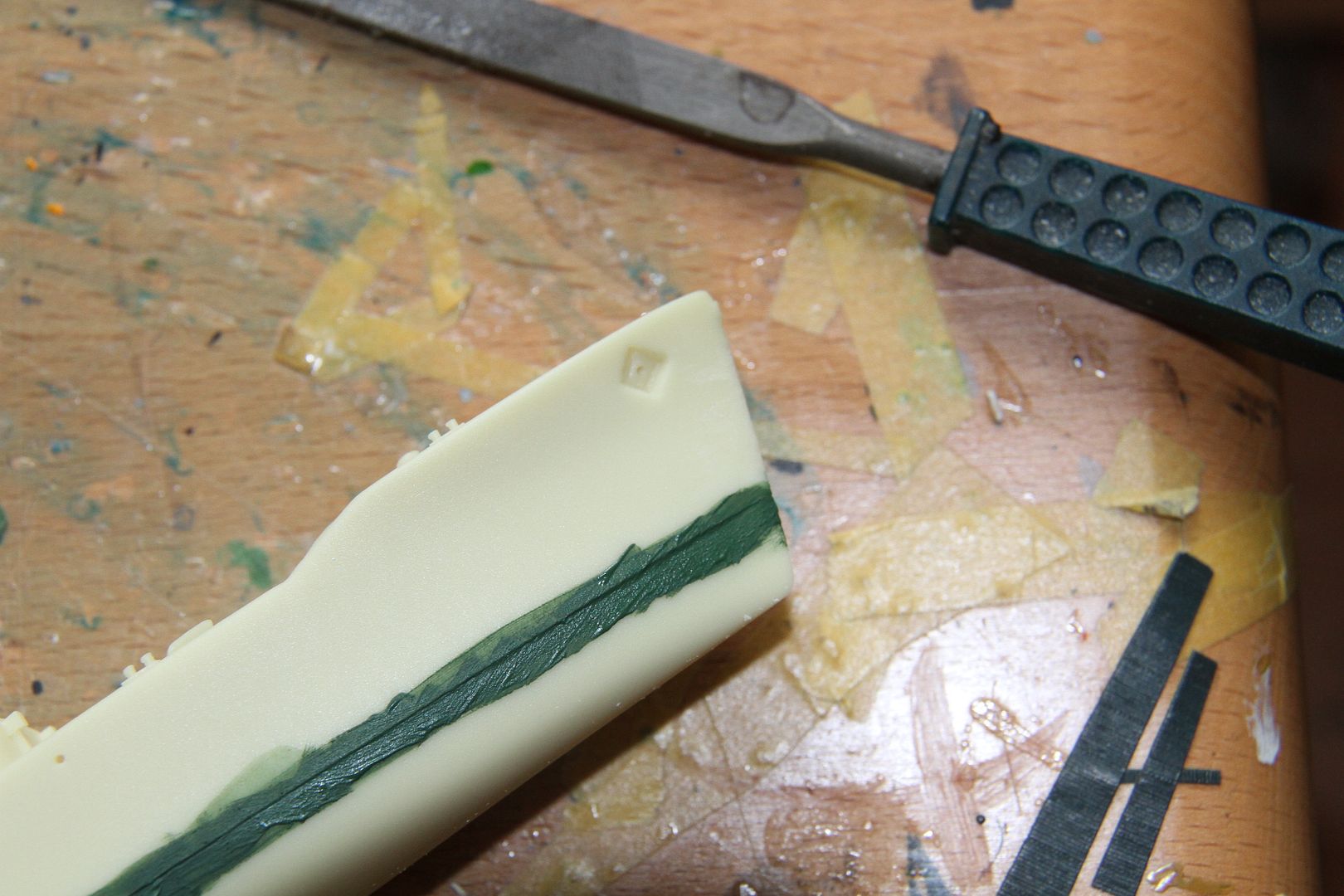

Finally got started.

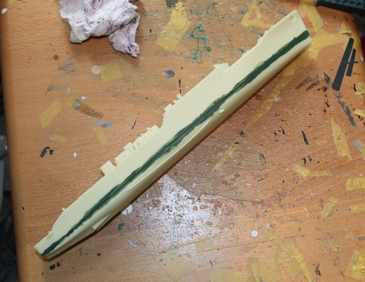

The upper and lower hull sections joined, pretty good fit, except for a few minor gaps and a little short at the bow.
A few swipes with a file sort out the bow, and the gap filled, I used Citadel "Liquid Green Stuff", great stuff comes in the same pots as their paint, can be brushed on, the brush cleaned in water.

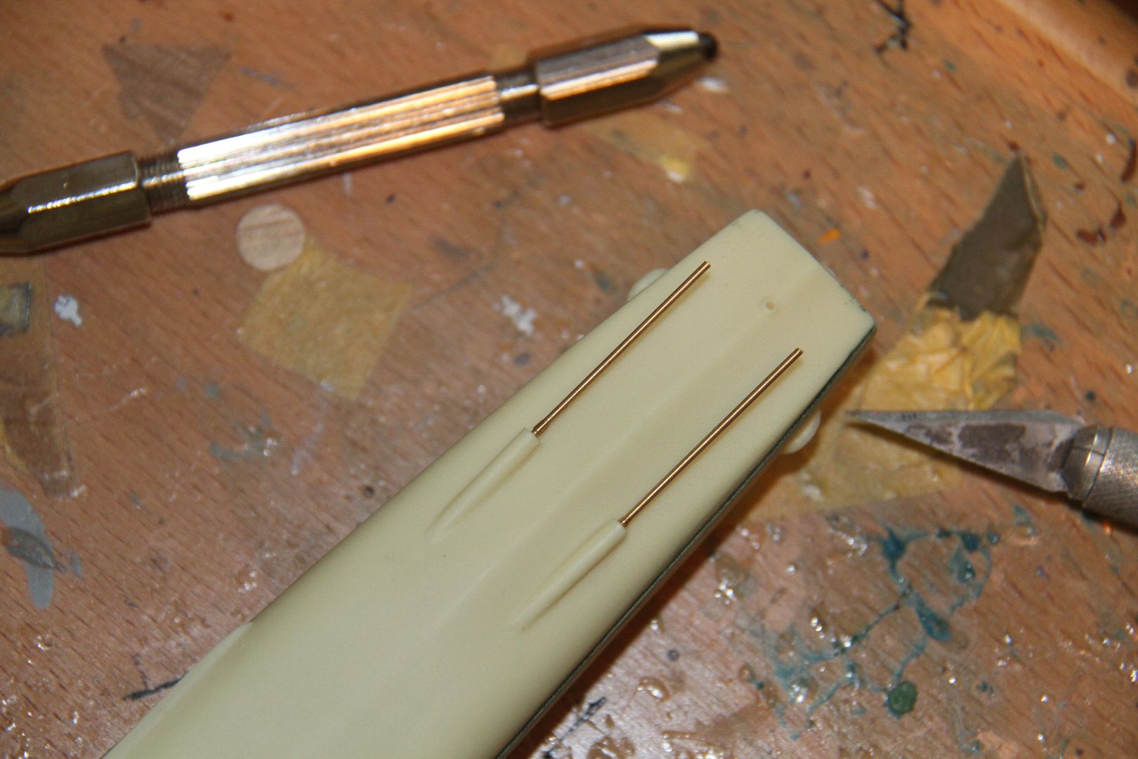

Brass rod fitted, at this stage overlength, for the prop shafts.
The brackets need cutting to fit, quite a bit as you can see.

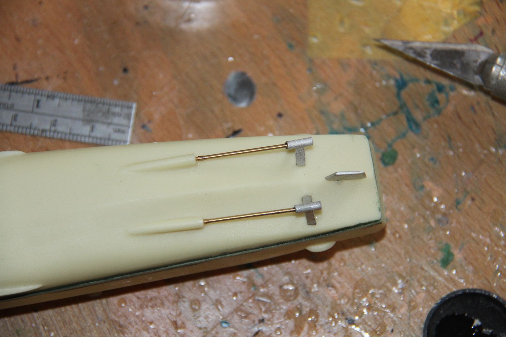

Brackets and rudder fitted.

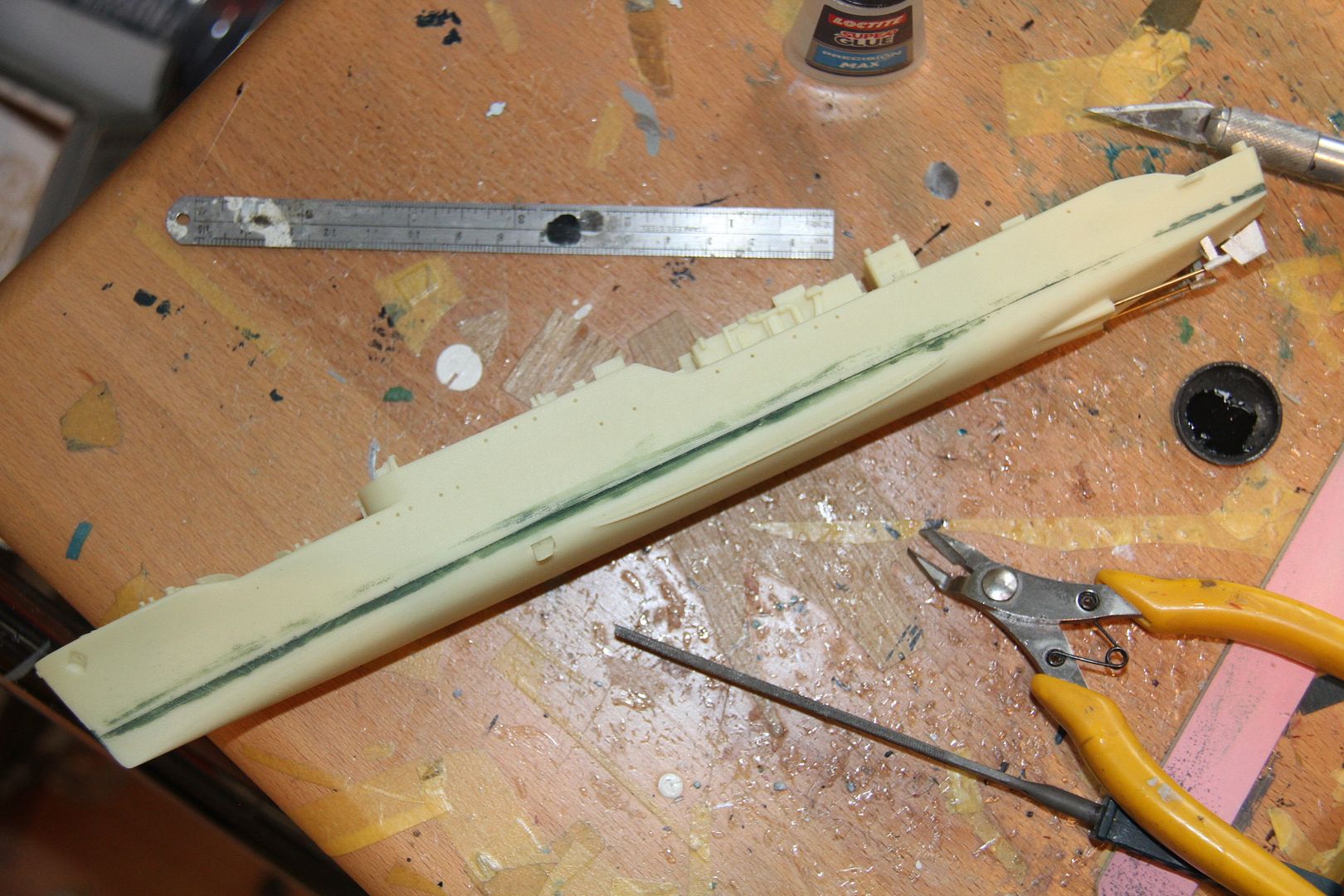

Side on, showing the join cleaned up.

How easy is the green stuff to sand?
RedDuster
Member Since: March 01, 2010
entire network: 6,819 Posts
KitMaker Network: 42 Posts
Posted: Saturday, June 20, 2015 - 11:36 PM UTC
Hi Warren,
It sand's very nicely, and dries quickly. It's onvy vice is that it shrinks a bit so it may need more than one coat.
