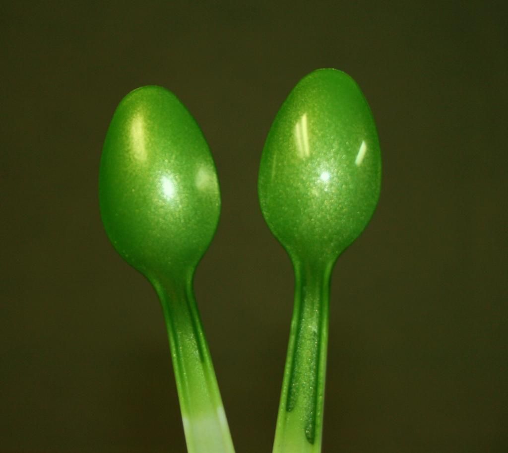

Since getting back into modeling I have been watching a few videos on youtube on the proper way to get paint to shine on a model car.
The spoon on the left is simply two coats of Model Master spray lacquer from a can with a coat of Future clear.
The spoon on the right is two coats of the same paint, wet sanded with 4000, 4500, and lastly 6000 grit sand cloth. I used some plastic polish after cleaning, then a coat of Future.
It doesn't really look that different in the photo, but in person the difference is stunning. Notice the overhead lights reflection in the two spoons. On the left are just light blobs, while on the right each light can be seen individually.
I'm really pleased thus far and can't wait to try this on my two cars for an upcoming campaign on AutoModeler!

Hermon, I've been looking at this too for my first car painting attempt. I can see youhave managed to get rid of the orange peel finish down to a smooth one. The thing that concerns me is how to do this over the whole model, as when it comes to raised detail and some shapes then you need to be really careful not to end up removing some of the paint completely. I already had that issue with my first attempt, as well other things going wrong with the striping, and had to start again...
I'm trying it with automotive paint as I think it will take the masking tape and polishing better than model paint, and so far it has, and looks smoother out of the can. I am also going to try with polishing paste rather than sand paper..Anyway, good luck with your actual car.

Nice work Hermon, a very good little prep test for the pending shenanigans!
That colour is going to look awesome on your build mate, nice choice.
Thanks for sharing your methods and results.

@Matthew: The sanding sheets I'm using are literally as smooth as printing paper so I'm not concerned about burning through the paint. Also, around raised details such as badges, door handles, etc., my personal opinion is that there is no reason to really get close to those details with the finishing paper. As long as the large areas are polished up really well the eye isn't as drawn to the less shiny or small areas. I hope that makes sense.
@Damian: This color is just some paint I had left over from a build a few years ago. My Camaro will actually be Arctic Ice Blue Metallic.....with a lot of oil stains etc. being a Chevy.
@Gabriel: You're absolutely right about the prep work before the paint. My test was done without any primer as I just wanted to see what level of shine I could produce with the micro sanding papers. I agree with you 100% about the prep work BEFOR the paint being extremely important. Also, I got the idea of using the spoons as test beds from reading your post about your mini.
