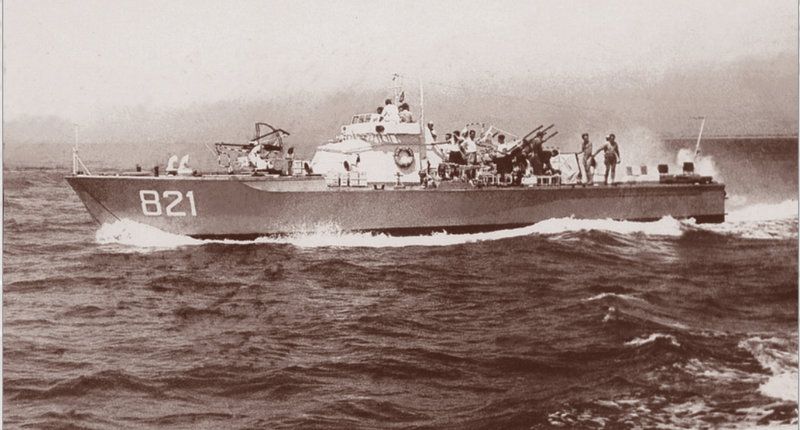

I found a pic today of former MTB 378 (72'6") in Italian service which seems to show two protrusions at the transom. To me this is proof that this series of craft had the same type of rudder/muffler layout as the better-known Vosper 70'(American built) craft in Italian service. In other words, I assume that 375 and 376 also had the Elco type mufflers and single cavitation plate.
I found the pic on this interesting Italian site:
http://www.marinaiditalia.com/public/uploads/2010_08_14.pdf
Arjan

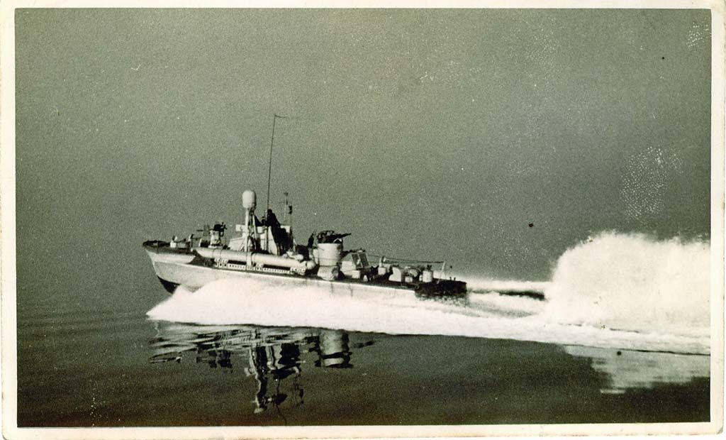

Thanks Kevin, I will certainly continue this project for the time being. I happened across some nice pics this week, terrific wake! The first pic was taken in the Adriatic, don't know about the second perhaps it's the same boat:
Some nice shots of the Annapolis Vospers:
Final pic is very useful because it shows the louvres in the rear vents. Probably best to make a resin cast of the Italeri louvres to reproduce these parts.
