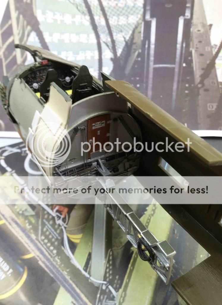

That housing is going to have to fit into that small opening at the start of the Catwalk? Seems to me that a few basic shapes glued together is all that would be necessary, as it's so small, and tucked away in the back of the bomb bay, that it would be next to unnoticeable.
Joel
In the front of the bomb bay actually, and you can see the "few basic shapes glued together" at the base of the life-sized transmission, just to the left of the black sprue where the "cap" to the model transmission is.

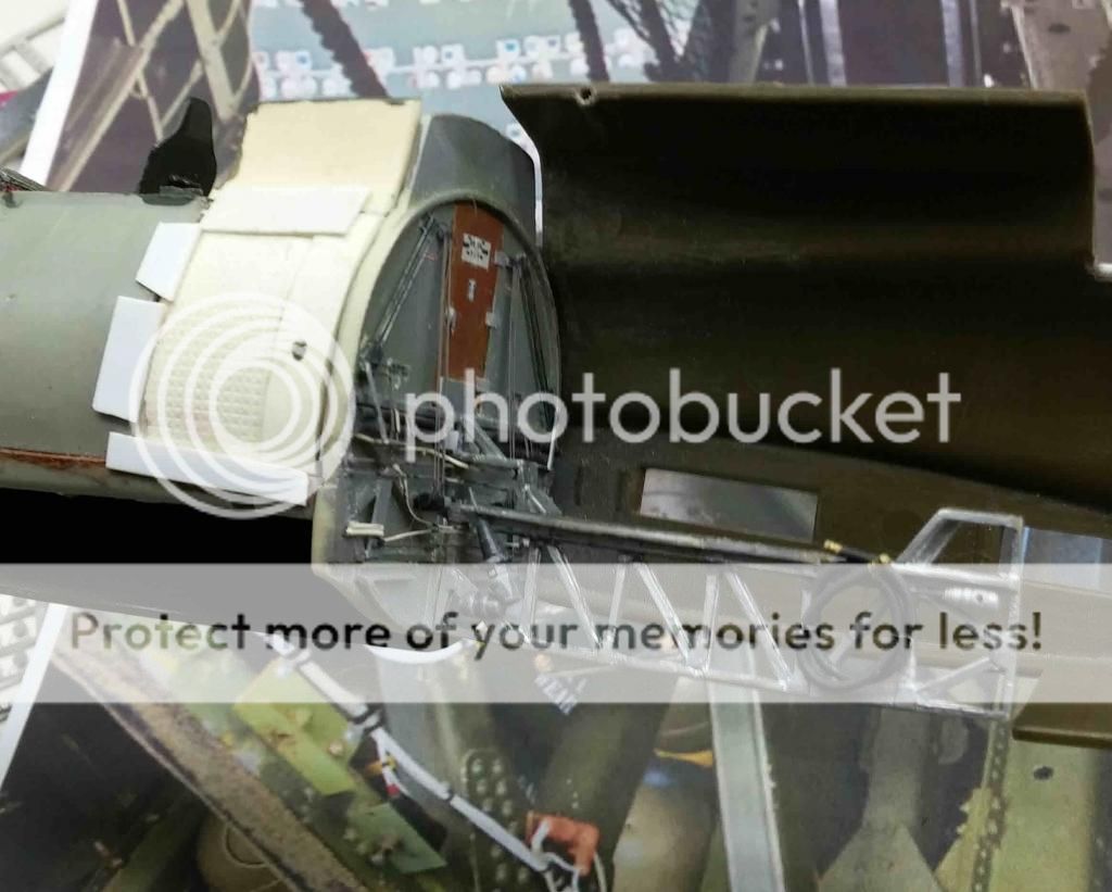

CATWALK COMPLETE - MORE OR LESS
I'm not in much of a "talky" mood tonight. I think I'll just let the pictures do the talking.
I like the segmented non-skid on the catwalk. Inspiration comes from real thing shot that's the photo backdrop. I do believe this will be visible, more or less, looking through the radio room hatch (where the gun is) through the forward radio room door, which will be positioned full open.
Side view showing the catwalk against the forward bomb bay bulkhead. When I actually get to the point where I glue the catwalk in I will add a hydraulic pump under the first step of the catwalk that will have additional black hoses going to the large hoses midway up the forward bulkhead on either side of the step. I will also squeeze in a transmission for the bomb-bay door actuators, and there will be some additional electrical wiring thrown in too. This will run to the transmission motor and along the bottom of the catwalk to the bomb release mechanisms.
Another shot of the forward bulkhead and catwalk just for fun.
Finally, above is a shot of the after bulkhead with the catwalk positioned. Lotta work here folks. However, it's definitely getting there.
I will leave the bomb bay now and finish the forward radio room bulkhead. After that I will be anxious to start on the the walls and ceiling of the bomb bay. The plan is to build it like modern shipyards build ships, modular style. All details will be added to each piece before it is glued in. That way I'll avoid excessive fiddling with a tweezers, toothpicks, etc. So long as I carefully plan the attachment points between sections, for things like wiring, control cables, etc. it should work out OK, I think.

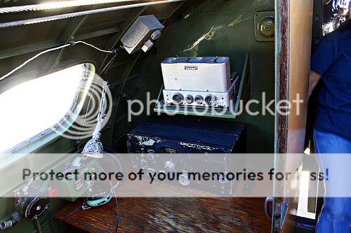

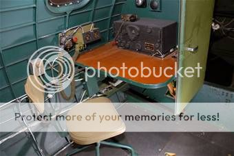

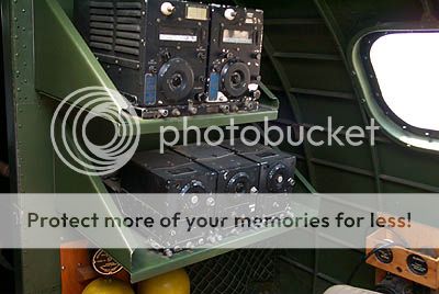

RADIO ROOM RESEARCH
I'm about to start in the radio room front bulkhead. It could look like this:
but I prefer to go with what's below in bronze green:
I think I will keep the radio gear in aluminum, even though some sources show it as black:
But, I will paint the portable oxygen bottles yellow, as they appear in the above photo, for the sake of consistency.
Build pictures coming before too long.

Posted: Wednesday, November 05, 2014 - 01:43 AM UTC
Brian,
Your reference material is also consistently setting a really high standard. Just one excellent set of pictures after another.
The 1st picture of the radio room sure looks like it's from a restoration with all the shiny bare Aluminum. Has the same spit and polish of a new car. The 2nd picture with or without the graininess, looks like what I would expect an operational B-17 to have looked like. My only question is the natural metal ratio equipment. I really can't recall seeing pictures of non-painted equipment. The 3rd picture depicts them as I would have expected that they were.
Joel
Redhand
Member Since: January 20, 2013
entire network: 1,316 Posts
Posted: Wednesday, November 05, 2014 - 02:02 AM UTC
Brian,
Joel
Thanks Joel. On reflection I think you're right and will go for the black. The first pic is from a B-17E restoration (maybe the bird salvaged from Greenland like the P-38F "Glacier Girl") that some gazillionaire is restoring to factory fresh condition. The mind boggles.

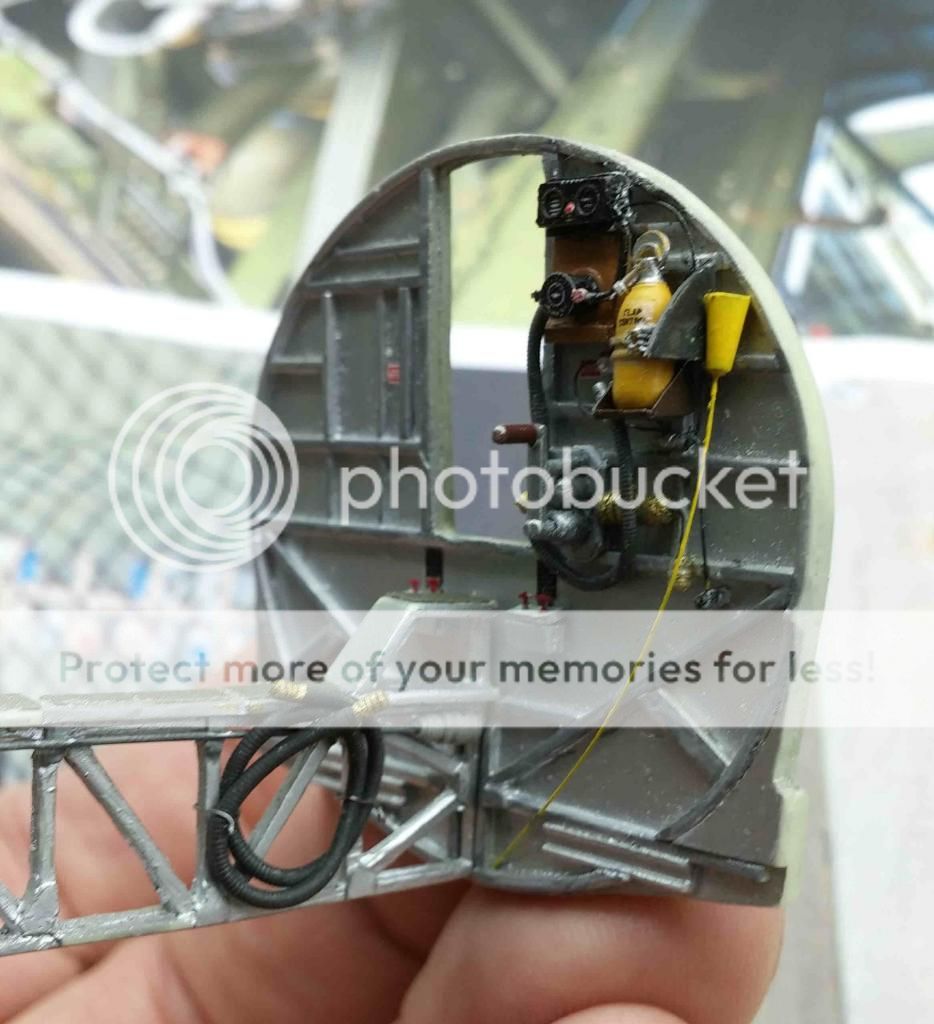

Posted: Wednesday, November 12, 2014 - 07:52 AM UTC

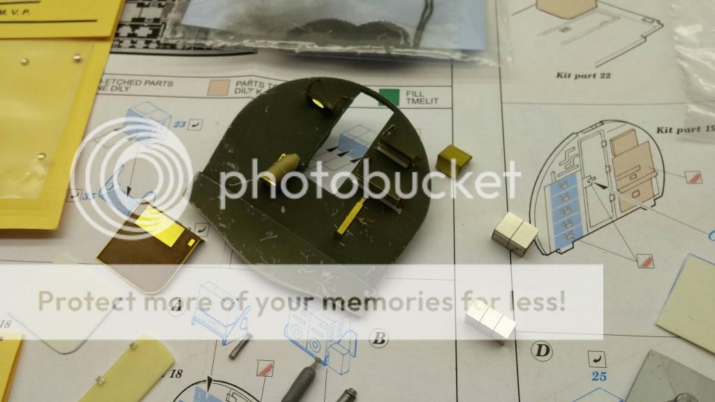

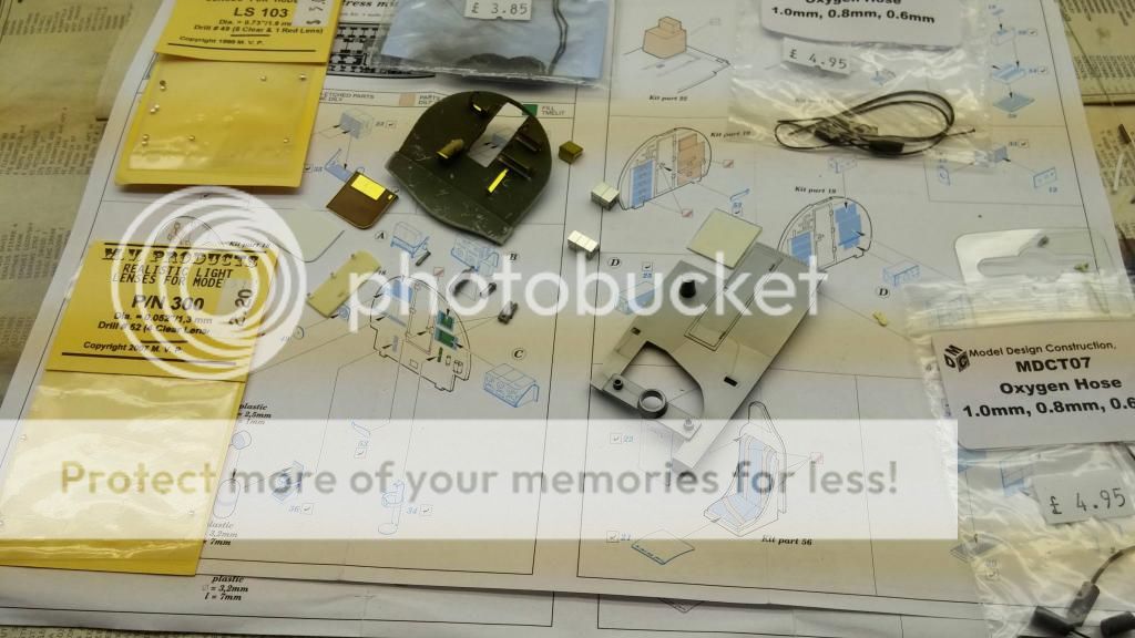

FORWARD RADIO ROOM BULKHEAD - PLANNING AND START
Well, I started on this last weekend and made some more progress tonight. See below:
I decide to glue the brackets for radios and fire/oxygen bottles on first, since I will spray the entire bulkhead bronze green, and I want the brackets to appear integral with the bulkhead. I will add the assorted gear you see on the instruction sheet lying around the bulkhead after I separately paint them.
One thing that will look neat (I think) is the table top. I will spray the top my medium-dark plywood colors,
and add a styrene sheet bottom. This I will paint aluminum so you can see a definite table edge to it.
I'll also add a table leg. See below:
If I really like it, I might go Full Butthead in my commentary
but don't feel obliged yourselves.

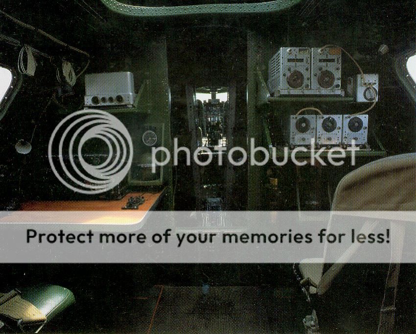

I did some further online research and one thing that is truly cool is this picture showing the radio cables going to the outside stbd. bulkhead where the outside antenna penetrates the fuselage.
That I will DEFINITELY do after making sure that the internal wiring is placed to line up with the exterior antenna.
Around the top of the first picture in this post you can see some goodies that I purchased for the build. More oxygen hose plus some fine chain from MDC that I will use somewhere. You will also see some neat light lenses that will be used for the bomb-bay interior lights (including the one on the front step of the catwalk leading to the cockpit). Those I was lucky enough to find at my LHS this past weekend.
I should have another post up this coming weekend. With luck I'll have the bulkhead done by then and ready to show, and be ready to return to the bomb bay. That, at least, is the plan.

Brian,
Is that picture from the restoration? Just seems rather odd, as well as the wires are white not a O.D. color.
Joel
Redhand
Posted: Thursday, November 13, 2014 - 12:31 AM UTC
Brian,
Joel
Yes, I think so. But period photos do show that white wiring predominated in these spaces, so I'm good with that part at least.

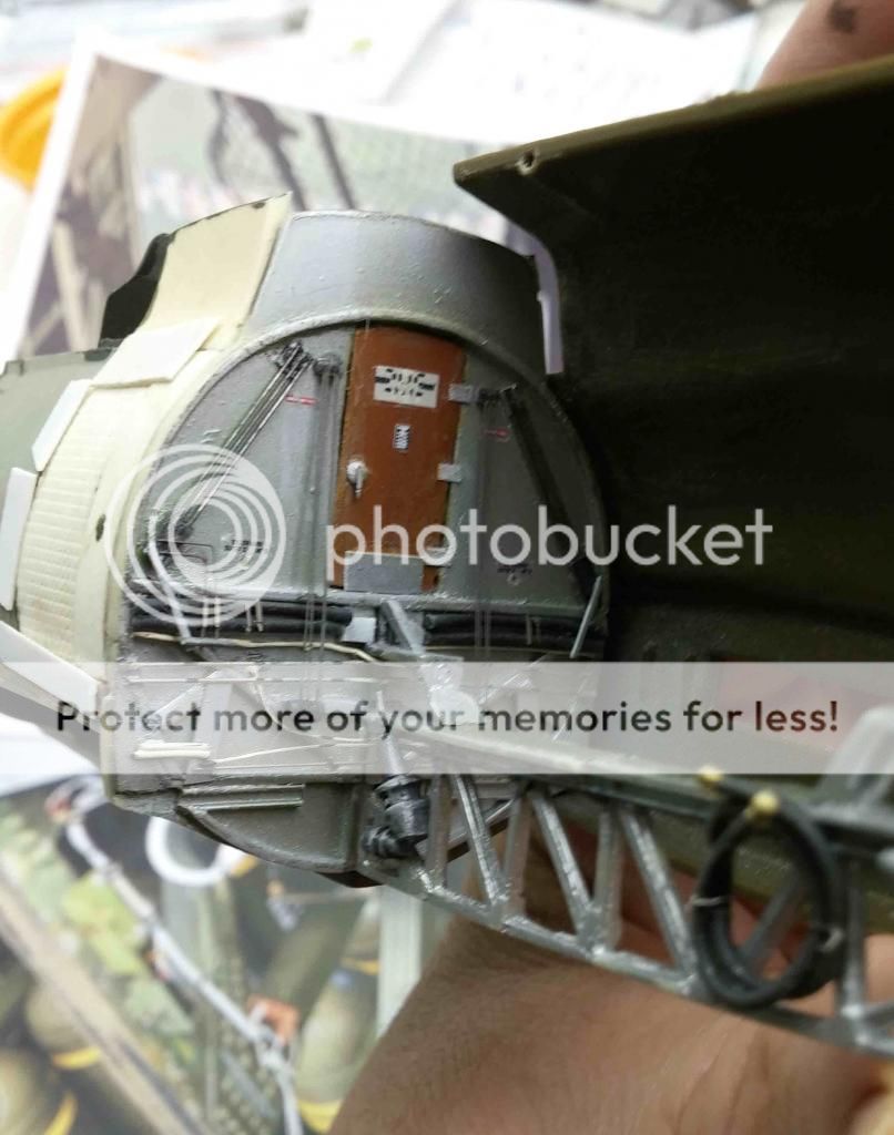

Posted: Sunday, November 16, 2014 - 08:47 AM UTC
RADIO ROOM FRONT BULKHEAD (CON'T.)
Well, I made some progress over the weekend: not as much as I hoped, but better than none!
Below is the forward radio gear painted and installed in the brackets.
You can see the bits and pieces that will go on below the door opening, and the beginning of my painting of the table top. Need to weather it with dark umber and then glue that beautiful main radio unit on. (The Eduard etched, painted brass front is very attractive, I think). I also have to paint and install the door in the open position off to the left.

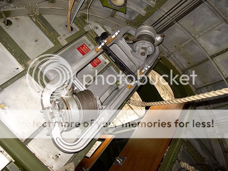

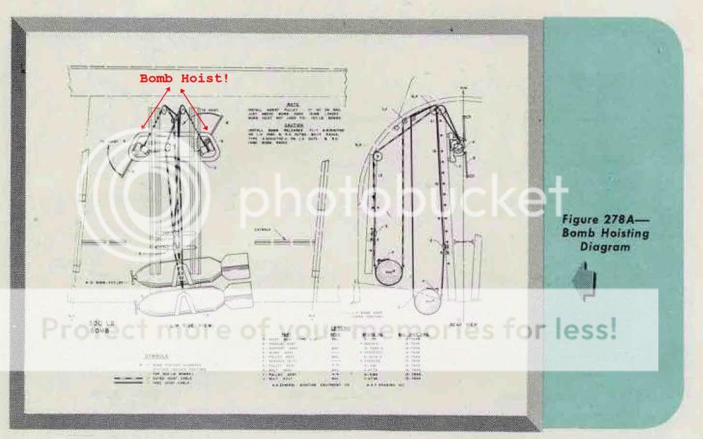

When I get this done I will return to the bomb bay, where further research enlightened me about this piece of gear located on the left side (facing aft) of the rear door leading to the radio room.
Earlier I couldn't figure out what it was to save my rear end. But it is detachable from the bulkhead, and when I did some thumbing through the B-17 Erection and Maintenance Manual I recognized the shape in a drawing. "Eureka!" It's the bomb loading hoist! See below:
Now that I know what it is, I will scratch build something that looks like it to hang on the after bulkhead. Before I hesitated despite seeing it in the pics because I could not tell if it was WWII equipment, or something else.
