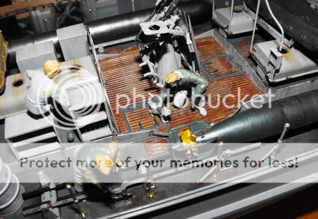

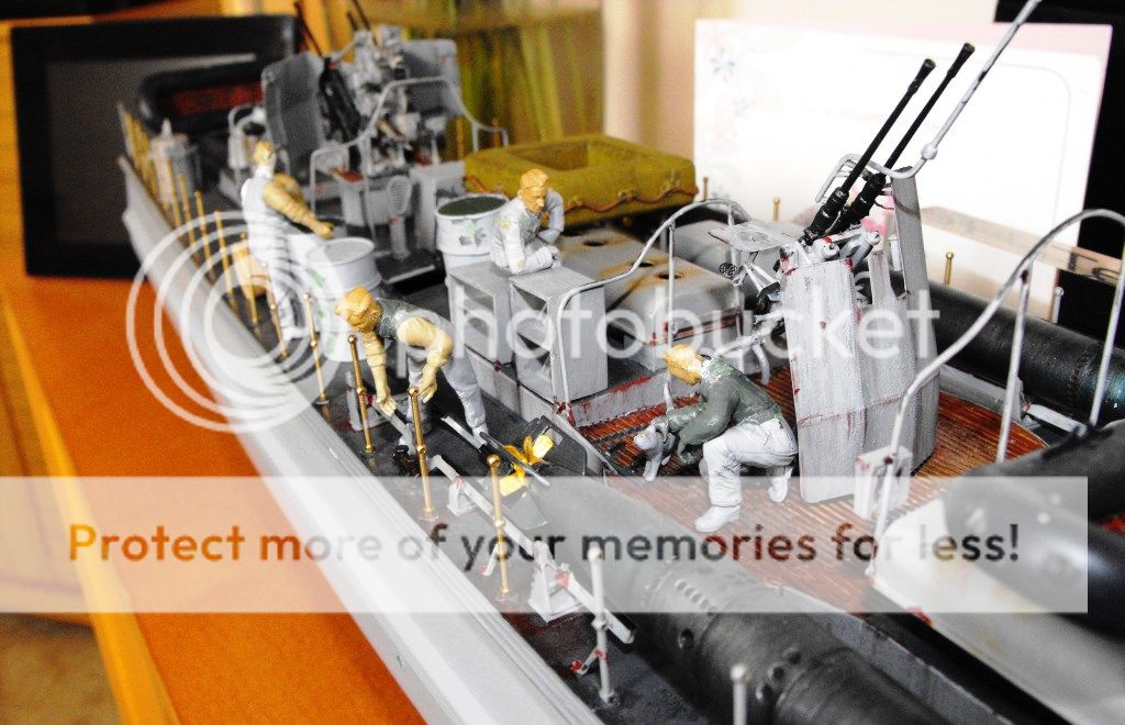

Thanks for the welcome guys. I have really enjoyed this build, and have used some of roberts excellent plans in my build.
However it isn't my intention to produce an exact replica of any particular Boote, rather to show a very busy working boat, warts & all!
There will be faults etc., however I am building it for my own benefit
IMG]http://i1041.photobucket.com/albums/b416/ojayspbody/Italeri%20Schnellboot%20For%20Web%20Pages/20mmQuadFlakVierling3.jpg[/IMG]
IMG]http://i1041.photobucket.com/albums/b416/ojayspbody/Italeri%20Schnellboot%20For%20Web%20Pages/FlakTubAndPedestalConversion.jpg[/IMG]
Some of my in progress build pics.
Gregg

this is absolutly the right approach. Everyone applies the level of detail that he wants: For me, I apply most things that can be detected from about 3 m distance (when the boat is on the water), and most relevant functions, i.e. Torpedotube hatches, turning Flaks, Flak sound, etc.
Is you model coverted for RC or a model for presentation?

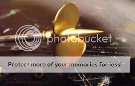

I am fitting 3x400 can motors with 4mm stainless shafts and 32mm scale brass props.R/C for speed control, rudders, Lursson Effekt etc..
Gregg

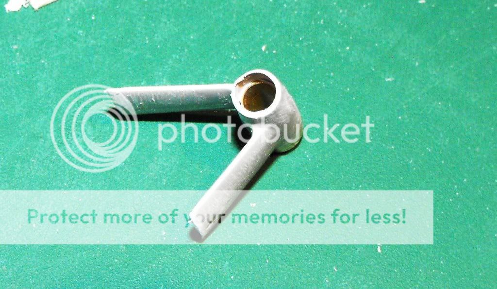

I had the same problem: how to fix the shaft tubes to the A frames? I simply put the tube into a polysterol tube, saned the original a-frame until a nice saddle remained an glued my PS tube to that saddle.
How do you plan to realize the Lürssen Effect? Sliding Servo? This weekend my wheelhouse fell of the deck when moving it so I am back to square one wrt the wheelhouse.

nice work, I see you must have access to a turning maschine. In case you want to shift from the kit propeller to real ones, you find "kriegsmarine" Style props from Raboesch: http://www.raboesch.com/CATALOGUS_2-2010_WEB.pdf Look at page 3, second propeller Kriegsmariene Style Old school.
bis denne
Christian

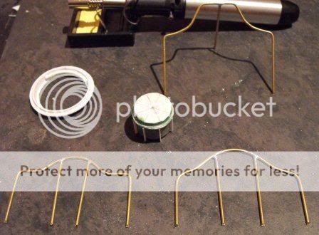

I started my 2nd Schnellboot, this time it will be an S19 type boat. Bute before building anything serious the groundwork needs to be completed. To this end I gave the measures of the ruders, rudercross (for the servo) for milling in brass, a central engine rib and lipocase to the miller of my Trust. Further I started to enlarge one bossing to fit around the propshaft. I did not remeber how long it takes to get the diameter enlarged to 6 mm: Anyway this is now done for the port side.
bis denne
Christian

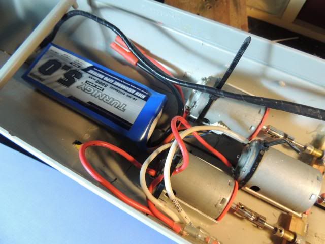

I tell them... My S-100 equips 3 engines 540 and 2 controls peed. central engine with a controller for common managing and the two external to full power. with another controller The battery lipo 3S 11.1 v 5000 mah ......
The tests of the weekend They were promising.... The managing with the central very good engine!!! Rapid enough and good maneuver..... But in straight line on having given him full accelerator with the day pupils the torpedera seemed to fly!! Great!!! But very little!!! The control speed of use shared in the external engines lit fire!!!!

I assume, that the power the two external engines generate (8 - 10 Amp each) exceeds in combination, what the controler is able to handle (just 10 Amphere single). I suggest to use also for the external engines 2 seperate controllers and combine their signal into one channel by using a Y-Cable.
3x 500engine, that is quite impressive, very fast but alos heavy, have you taken anvideo from the journey?

I m thinking 3 controllers and to join the exteriors in " Y " and to eliminate the red cable for the BEC. Also Im thinking about feeding with battery Ni-MH 7,2 v 5000 mAh. The lipo 3s 11,1v too much for the ESC. You who thinks?
I think of eliminating 1 cell of lipo and of turning her in 2s and of adding an alarm of low voltage not to damage and to use her as refill of the NI-MH.
But I not. Probably be better to buy neither other one NI- Mh of supply. Jejeje
Much to learn!! Jejejej

when when the controler of the central engine was able to cope with the 11,4 V, then certainly the others wil be able to do too.
But the controler has a Voltage nad from which to which they will work. Mine operate from 3,5 to 14 V, so take a look at the spects the controler have and ready to go you are.
The powercells you have should be sufficient; I would try the lipo first as his NiMh pendant is heavier than the lipo one.

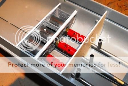

I made some progress on my new S18 Build. I established a shim to hold the middle prop shaft put some (bathroom) silicon in place, put the shim in place and afterwards put the propshaft in position, before watertighten the whole hull.
and here the propshaft is in place
Making everything watertight:
bis denne
Christian
