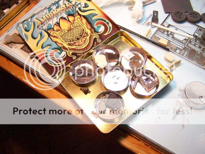

[quote]Oh yeah Phil, here is the stuff that I used for the press mold
I picked it up at one of the crafty stores just to try it out. It works good for simple quick molds (in fact it's time to pick up another set!).
Thank you Jonathan! another good tric down my sleave, this tread is making me learn a bunch of new technique.
Philippe.

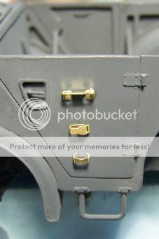

This one follows right along with the good and bad PE. I went ahead and built the door handle assemblies...
But they didn't quite fit the pockets...
These pockets had been enlaged from the original to fit the PE edging from the same kit, but I'm not sure how they thought the handles were going to work. So I made my own out of wire.

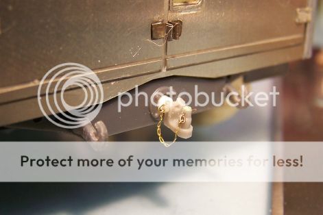

Next I went to the back of the truck and built the rear bumper and hitch with a bit of extra detail.
Added the convoy lights and reflector
Finally finished up the rear door steps
Of course this was an all day project that included some of that fun floor time searching for dropped parts, but all in all not a bad day.
Getting closer and closer to paint time!

Nice work on the door handles and chain hanging off the hitch. I like the look of the wire door handles over the pe ones.

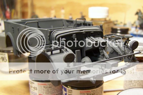

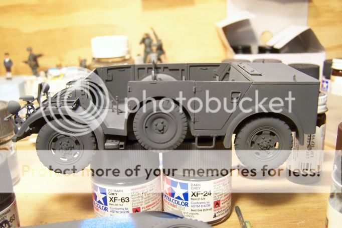

OK guys, here goes nothing...
A little early maybe, but hey I can't wait any more...
Some paint to tie it all together...
Whatta ya think Gary? I was pleasantly surprised, I thought sure there would be more clean up work once I got a coat of paint on there. One big sigh and back to work!

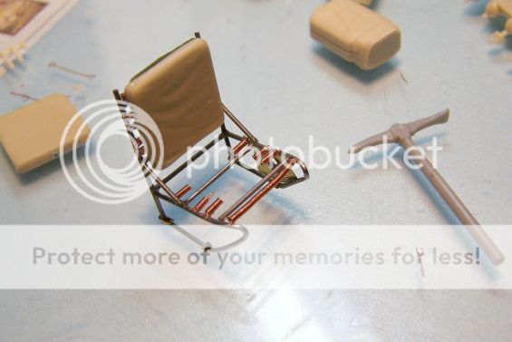

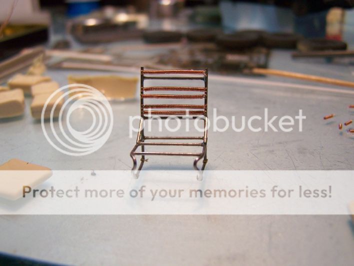

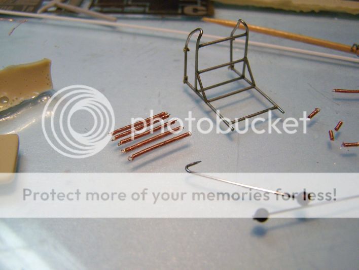

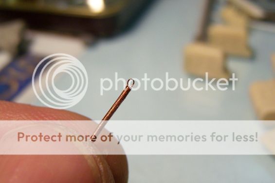

Then back onto the seats. There are springs behind the cushions for support (comfy), all I needed to do was build them. So, with some pins and some wire I went to work
Twisted up the long coils and super glued them
Then used the hooked pin to make loops to glue on the ends

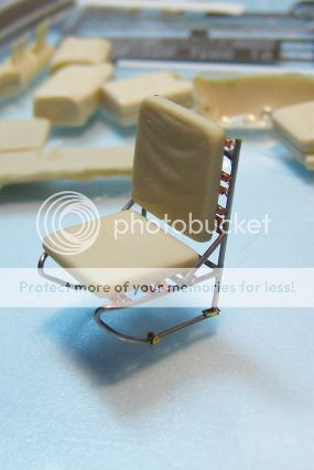

Put 'em on the frames
Resin cushions on that
And a little green stuff to make the flaps in back

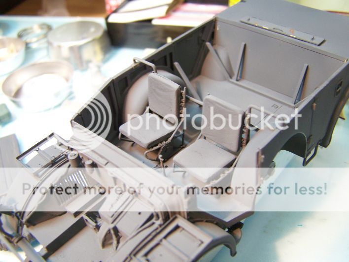

And the seats are done! I should probably paint them...
almost done!

I am happy with the seats,
But Mauro I must confess I did cut some corners!

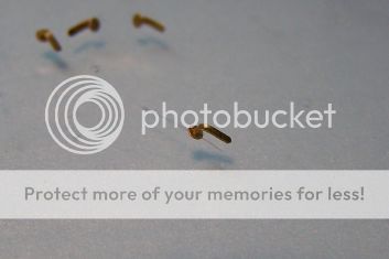

There was a great disaster last night too... Ohhh very bad...
When this
Jumped off the shelf! And landed on my small parts holder...
Flinging tiny pieces everywhere... Needless to say I was not very happy, but my floor sure is clean now. So far it looks like the important parts were recovered. I still live in fear though that the one final piece I need will be missing! Ohhh the night mares!!!

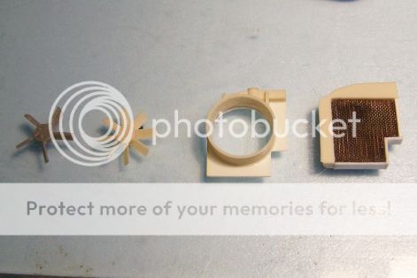

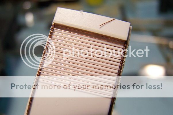

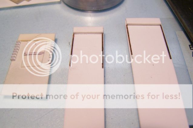

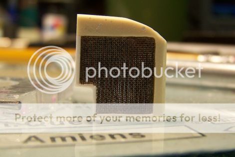

Well I went back to work on the radiator. I figured I need that done so when it's time to mount the engine I can fit them both at once. So back to where I left off with the prototype. I wanted more water chanels and less glue deposits. That means I need a new jig. Here is the evolution, the one on the left is the original, the one on the right the final...

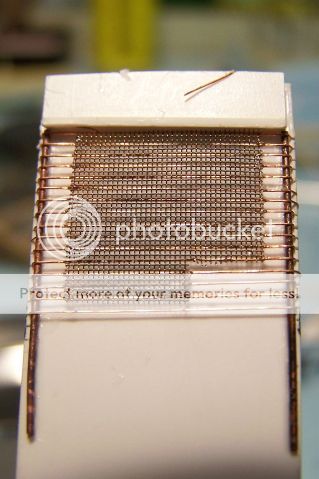

With the final design the wire is wrapped around the jig.
And the screen placed on top then the glue is applied.

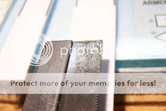

The spacing for the wire was made by cutting a notch along each tooth of the saw blade.
Four panels are made with the wire channels and are glued together with a fifth to make the core. The core is then glued into the original framework.
I copied and split up the original radiator to "refine" the assembly
So the final pieces look like this
So that's that until next time!
