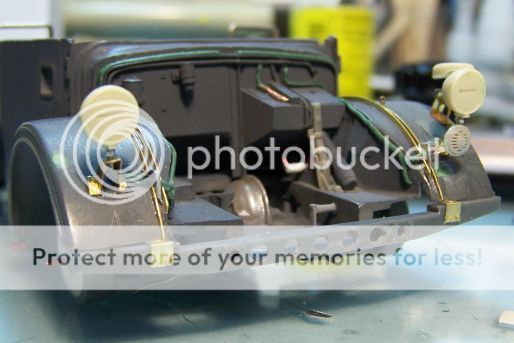

All right, here we go agian. Now I was having this delima last night.
I wanted to replicate this...
So I started by just bending some wires,
but that wasn't getting it, not enough wire and tooooo large a bundle. So I was thinking, and thinking, and thinking, and decided to try this.
Twist some wire around some plastic rod...
Flatten the coil, glue the edge, and cut it in half...
Then trim a little off the top...
Drop it in place with a litte rolled green stuff to finsh out the loom...

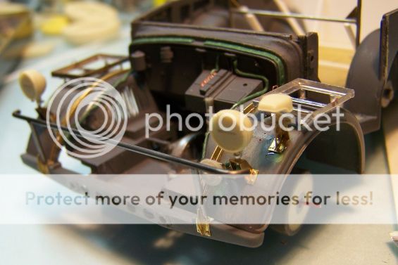

I left off staring at that notek mount and sure enough I didn't like it. So I angled it forward and shortened it up a bit...
I pulled the first casts out of the new molds too, not too shabby, the water can handles need some help. I think a little more attention to them when I'm pouring and they should be just fine.
Too much staring at the wiring harness, so I had to pull the end apart and add a little bit of metal where the hood tie downs mount and the harness runs through.

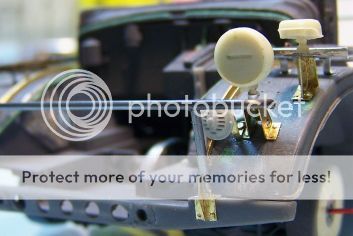

Next I did some head light working, I was wanting to make the cloth covers but I couldn't get them to look right, so I scrapped that part of the project.
My next great idea was building the can holders for the fenders. I made a form (after I failed at freehanding them)
I used the heavy foil to make the angle iron frame.
Fabbed up some mounts and mounted them.
That sounded like it went quick, but man it didn't go quick at all. There were quite a few not good enoughs, and a couple flat out fails! But eventually...
Then I made the push bar, the first version was too short, so I added a little length to the uprights and it's looking good.

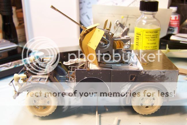

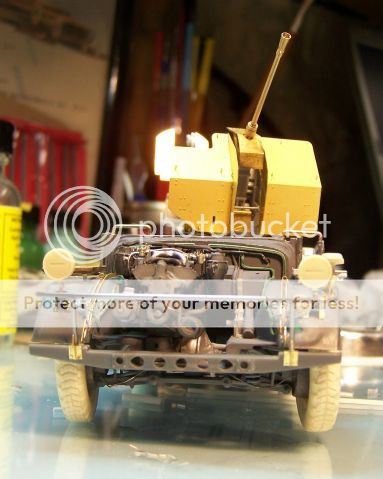

Too much staring! It looks like the Horch is going back under the knife for a face lift. The head light mounts need to come down the fender and the push bar uprights need to go back to the smaller ones that I had made. I'm about ready to be done with the front end of this beast!
Babcat
Michigan, United States
Member Since: March 21, 2006
entire network: 269 Posts
Posted: Sunday, February 19, 2012 - 02:49 AM UTC
After a quick slice and dice, here are the results!
Amazing! It looks like a completely different Horch...
OK maybe not that different...
I feel better thouugh...

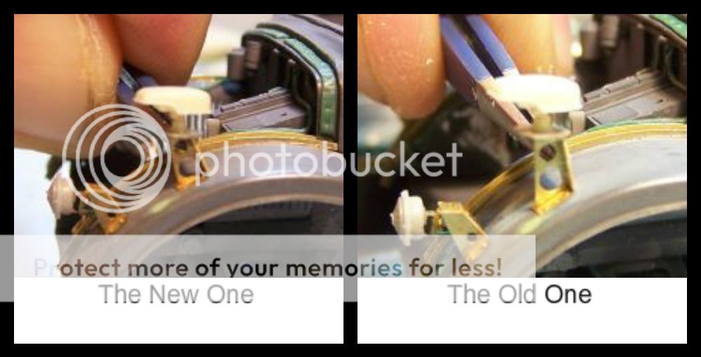

I needed a little of that detail back that I shaved off way back when. So I grabbed the old kit
Did a little press on mold
Poured, sanded, trimmed and installed, up on the front fender.
I was thinking about this one for a while and it worked out pretty good, I did both sides with the one mold and sanded the piece while it was still in there.
A little bit more trimming and folding and the new steps are in place
Then back up front and with some very small PE and a little plastic rod, the hood tie downs are done and installed (for the hood that won't be installed).
And to finish it up I put on a couple of door hinges
it looks like I will have to scratch the body side of the hinges since the PE set only had the door side for three six out of the eight. Once again, I just don't understand, but whatever we'll git-r-done.
